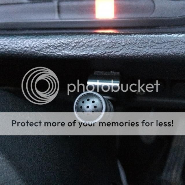

Posts: 1149
Re: Head unit hands free kit
Post by g8jka » Tue 22 Jul, 2014 20:06
Mine is just under the instrument cluster next to the steering cowl, no problems at all.
Image[/url]
Post by bertiejaffa » Tue 22 Jul, 2014 22:50
g8jka wrote:Mine is just under the instrument cluster next to the steering cowl, no problems at all.
Image[/url]
Ditto for me, just on the other side of the steering wheel
