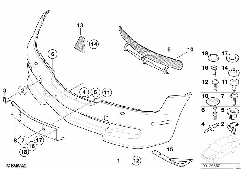

So on realoem I found this page:
http://www.realoem.com/bmw/enUS/showpar ... Id=13_0934
This is quoted as being the Z3M model but this is exactly the same as mine is already. Is this what you are referring to or are you talking about a different style?
Re: Intake questions
Post by pingu » Sun 12 Feb, 2017 22:43
The one above is the realoem for my car, but it is wrong.
11 is actually a hose that goes from the bottom of the filter to the brake duct (Item #7 below)...
The brake duct fits in the hole where your foglight is...
Sorry for the poor explanation, but realoem is really poor in this area.

Ahhh okay. So is that set-up (basically what I suggested in my second option) what the Z3M comes with stock?
At the moment the airbox is fed via item number 1 on the second diagram you posted. Which sits behind and around the headlight.
Thanks for the helpful explanation! At some point I will wrangle the fog light and bumper off to see if there is space for my scheme.
