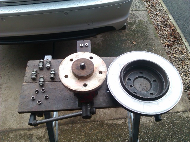

Post by pingu » Mon 03 Nov, 2014 19:08
Have you ever thought "Those discs look rusty, I wish I had something to clean them up with".
Well, here it is the Pingu Disc Skimming Attachment for a pedestal drill / milling machine...
How to make and use it...
and the maths behind finding the Pitch Centre Diameter (PCD)...

Post by maurice the martian » Tue 04 Nov, 2014 09:23
Inspector gadget srikes again, is there no end to your inventions,
Must say tho im a bit stumped as to the operating process,or am I being thick ,
M

I have had this in mind for the last couple of years but never got around to it, great minds think alike eh! :wink:

Or u could do it on a small lathe.
Just sent a shiver down me spine.spent nigh on 20yrs bent over a lathe.
M

Post by pingu » Tue 04 Nov, 2014 17:44
maurice the martian wrote:Or u could do it on a small lathe.
M
Small lathe is too small. 180mm od is about the biggest job before it fouls the bed.
