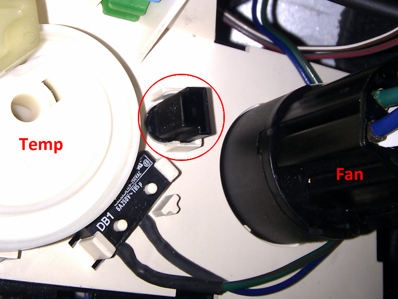

I have just spent the last hour battling with my heater bulbs. I first removed the (non-BMW) stereo, only to find that the cage was going to be a pain to get out, so then went in through the drivers side footwell - I thought I was doing a bit well when I immediately managed to find and remove the connector to the right-hand bulb - and indeed I was proved right shortly afterwards as the bulb refused to come out. So I then set about the Mike F technique and removed the stereo cage followed swiftly by the heater controls - at last I could see the back of it - but I still can't see for the life of me how the bulb is held in place. It will twist slightly, but shows no sign of coming out. I managed to replace the left-hand bulb with no trouble (when I finally found it on the bottom of the heater controls). If anyone has any insight on how to get the right-hand bulb out, I'd appreciate it - I've stopped for lunch before I go and do battle with it again.

Thanks for that. In the end I unplugged the fan connector and poked the heater controls out of the side of the console into the footwell where I could get some leverage with the pliers and the little blighter came out with a bit of a tug. New one back in and reassembled. I have hopefully got a couple more photos that I can add to the KB thread now showing exactly where the bulbs are.

If the bulb had come out easily, then the right-hand bulb could definitely have been changed by only going in through the drivers footwell, but there is no way I could have got in there to yank it out with the force it actually needed. You may be able to do the left-hand bulb that way, but as I couldn't even see the wires leading to it, I didn't know where to put my hand. Now I know where it is, next time, I might try it all through the footwell. TBH removing the stereo was not particularly difficult, other than the cage on mine fits by bending pieces of it outwards to lock it in place. You have a lot more room to work with the stereo out, as with a little jiggling even the BMW to ISO adaptor with come out through the cage.
I did not fully detach the heater controls, as the bowden cables look an absolute pig to remove. However with the fan switch connector removed, the controls would rotate so that the dials were facing downwards and the opposite way round to how they normally sit (i.e. direction control nearest you) and could be poked partially through into the footwell with the bowden cables still attached. This meant I could get to the bulb easily and get the pliers on it with enough force to pull it out. I seriously thought it had been superglued in, it took so much force to get it out! There is no way the controls can come out through the stereo aperture, as they are quite deep. Having said that, I didn't actually try after I removed the fan switch connector.

I updated the knowledgebase article with some clearer pics taken with my camera, rather than my phone.
The panels do not remove easily, and the footwell really is the easiest way in. With a good torch/lamp it should be quite easy provided yours isn't stuck like mine was.
