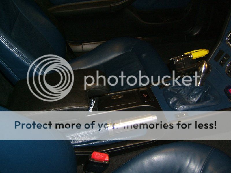

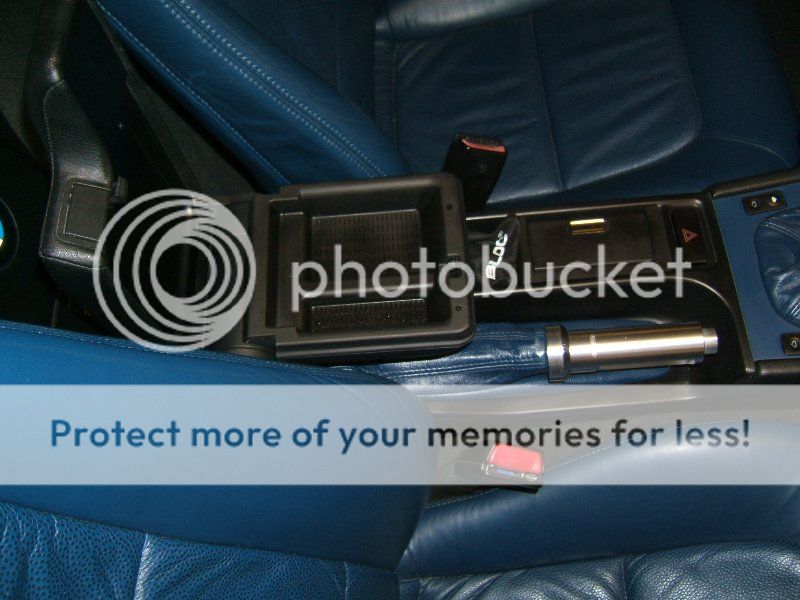

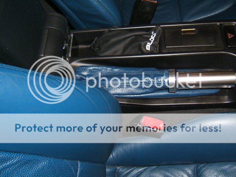

I have finally got around to taking some picture of my efforts at an armrest utilizing an armrest and mounting from an E46 Compact sourced on Ebay for £21inc.The original mounting has been reduced in height and bolted through the centre console with a re-inforcing plate underneath.I decided on the black as the armrests on the doors are black.
Armrest up
Oddments tray
Armrest down

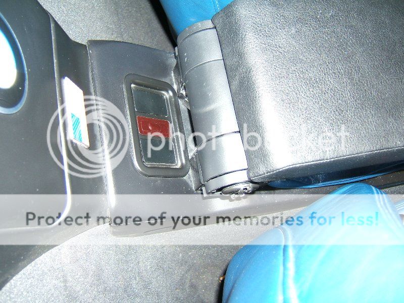

That looks good and neat and you get the oddments tray as well. Looks to be just the right height as well, I could never understand why one was never fitted as standard. Can you still access the switches at the rear of the armrest for the electric roof?

Looks good and the armrest really was a gift at that money, its a nice addition to the interior, was it a simple job? :)

Brian4 wrote:Hi Frank
Brian,
Here is a pic of the rear of the armrest showing the switch panel.my hood switch is up front,but as you can see the oanel is still accessible.
Dave,
There are plenty of E46 armrests on Ebay at £20-30 mainly in black or grey leather or vinyl.Most have the bracket still attached.Not difficult to fit.After cutting down the plastic mounting bracket I filled any voids with body filler to stop the mounting being crushed when bolting down.I made a cardboard template of the reinforcing plate before cutting one out of 16swg steel.Bluetack or double sided tape was necessary to fit the nuts as space under the console is limited.Working in the centre on the car is not easy,well at least not at my age. :roll:
