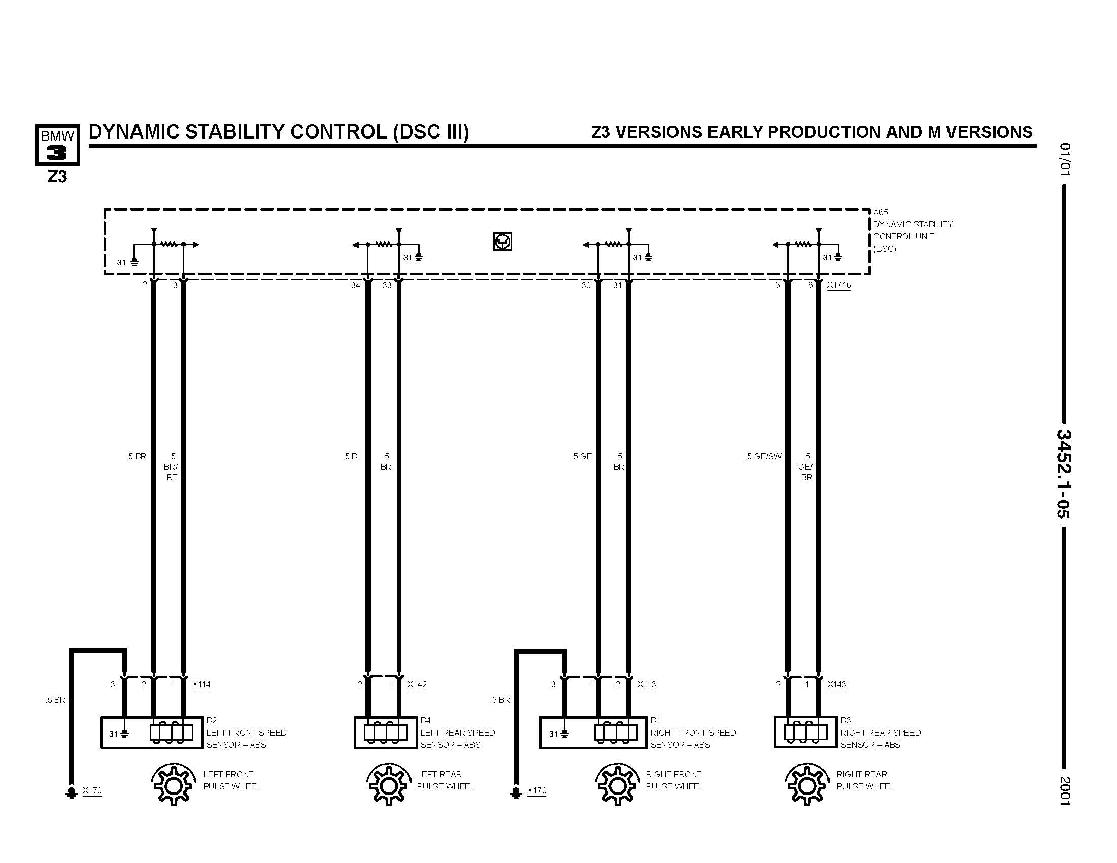

Great news - had been looking at wiring diagrams and was going to suggest fuse but you beat me to it.

Tufarlian wrote: I can get the allen bolt out but the sensor itself is still stuck in there. If I knew it was duff and I had the replacement I'm sure I could get it out but I don't want to damage a possibly good one.
Not relevant to you now, but you can test a sensor if you have an analogue voltmeter. Connect the two sensor wires to the voltmeter and spin the wheel. If the needle flutters, sensor is working. Good quality digital voltmeters can also be used, but the lag in a cheap voltmeter means the test may not work.

Great tip Pingu, I see that the wheel sensors get their ground from the securing bolt, do you need to put the multimeter across the two terminals of the sensor or do you need a ground for reference?

Brian H wrote:Great tip Pingu, I see that the wheel sensors get their ground from the securing bolt, do you need to put the multimeter across the two terminals of the sensor or do you need a ground for reference?
I assume the two wires, but you should really test a good one to find out.
I wonder if the earth connection is to ensure that the trough of the ac voltage is 0v. If it wasn't earthed, could the voltage peak be too high for the electronics in the ECU?
RobertT has more knowledge about these things. I only really understand things I can hit with a hammer, or prod with a stick. Electronics are like black magic to me.

pingu wrote:....you can test a sensor if you have an analogue voltmeter. Connect the two sensor wires to the voltmeter and spin the wheel. If the needle flutters, sensor is working....
Useful to know. Makes it possible to test a sensor without having to remove it.
Re: DSC light comes on at 20mph
Post by pingu » Sat 18 Jan, 2014 20:11
It looks like it is as I guessed. The sensor will be excited by the spinning wheel and it is the two wires that go to the car that should be checked for an alternating voltage. I still don't know what the earth connection is for :shock: .

In the meantime, I may buzz through for continuity, from the wheel sensor plug to the ASC pump connector.
Can anyone point me towards a wiring diagram that gives ASC pump pin numbers (and colours) for the 1.9 M44 1998 ?

You can download the ETM from here: http://wedophones.com/BMWManualsLead.htm

Correct me if I'm wrong but I can't see any wire colours on those.
In addition the pin #s in the schematic don't seem to match the pin #s in the list.
