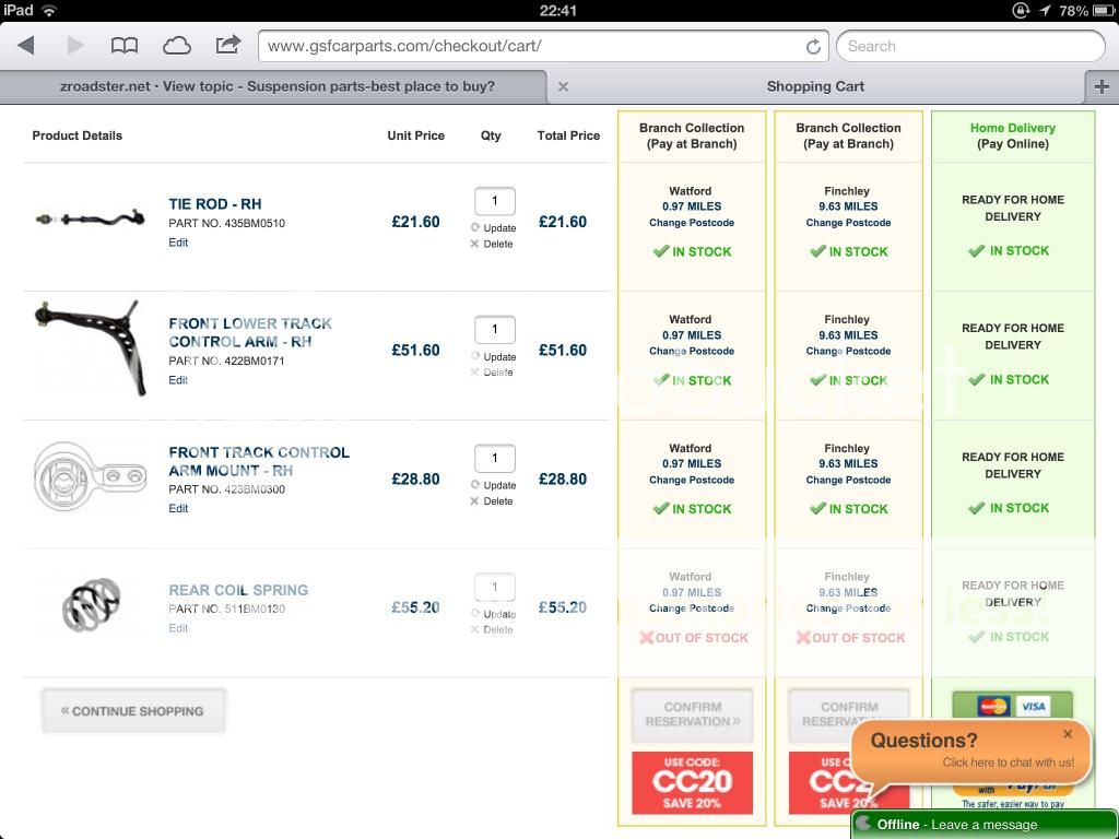

So, does this shopping list consist of the correct parts chaps:
That's providing I only decide to do one side obviously, for the saving I reckon Ill just do both sides and bung an oil filter in there too- GSF are cheaper than Euro for me anyway... £141.48. Not bad at all.
Also: is 'RH' the drivers' side... right?
2000, 2.0 manual, topasblau, blue leather. Now for sale: viewtopic.php?f=11&t=40699
