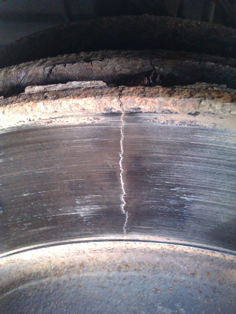

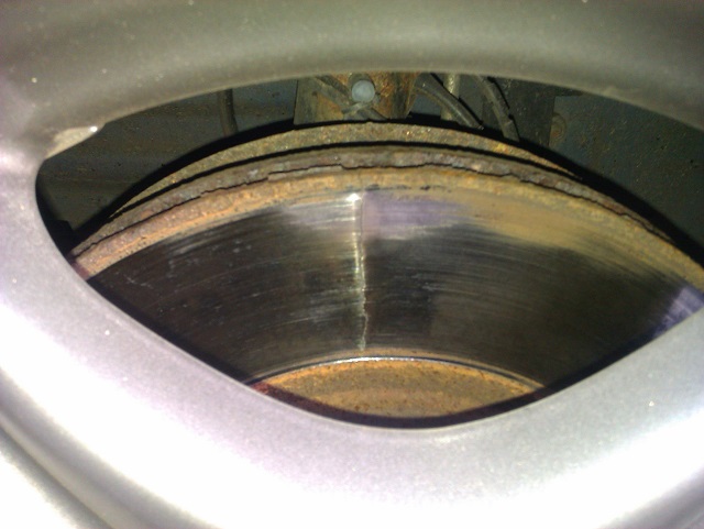

Post by pingu » Fri 07 Aug, 2015 02:32
Like the title says, I'm not sure if I should bother fixing this. It's only making a slight noise and there's only a little vibration...

Try sourcing a second hand part from a breaker and replace it. It's the rear disc / drum, so not as serious as a front. However, you really don't want a disc coming apart whilst driving. You could end up having parts smashing into the bodywork under the wing and arch.

Certainly needs replacing, when it comes to brakes don't mess about its a life and death component and not necessarily your life.
It would fail an MOT in this cracked state.
I would change both sides given the state the cracked on is in the other won't be far behind.
New pads at the same time.
You should source the parts at Car parts 4 less or Euro parts on the web, expect £120+ for each disc.

It looks like a front vented disc on a 2.8.
Those who advised you to 'leave it' etc obviously have a death wish,and/or do not know what they are talking about - they are a very bad adverisement for DIY maintenance!
A cracked disc will not operate too well, and will also wear the pads quickly - not to mention making the car unroadworthy. forgetabout fitting a used disc unless you can measure the thickness - but your other front disc is probably close tothe minimum anyway, so a new pair of discs and new pads are the only real answer. You do not have to spend a lot - visit GSF and ask.
Remember that a cracked disc may break up and lock the wheel - whic his not fun on a front wheel.

Post by pingu » Fri 07 Aug, 2015 11:43
Hairyscreech wrote:He has just said in the brakes thread he has a full set of pads and discs on the way.
and that was posted BEFORE I posted this :wink: .
Anyway, when the new stuff arrives, it can sit in the loft until I REALLY need it :shock: . Although, just to protect the bodywork, I may fit one of the new discs (it doesn't matter which one, does it?). :wink:
I like the idea of welding and grinding back - I might give that a go and see how I get on. The gap in the wheel is a bit tight to get the welder nozzle through, but it might be worth a shot :) .
I also like the idea of just turning the wheel and the problem goes away :D .
BTW, it's the front left disc on the M.

Don't use your car till its fixed the disc could shatter at any time leaving you without any brakes or worse, a friend in another kit car club had some thing like that in his tin top, his wheel fell off as he was leaving his drive

Southernboy wrote:Try sourcing a second hand part from a breaker and replace it. It's the rear disc / drum, so not as serious as a front. However, you really don't want a disc coming apart whilst driving. You could end up having parts smashing into the bodywork under the wing and arch.
Used brake discs from a breakers? - false economy, chances are it will be as bad as the one your replacing - we're talking brakes here - get new ones and replace both sides, and change the pads at the same time.

The sad thing is the discs were left to get to this point. Discs have a minimum thickness and should be checked for it.

stevov wrote:The sad thing is the discs were left to get to this point. Discs have a minimum thickness and should be checked for it.
Disc was measured on 14/07/2014 and was 26.79mm. Minimum thickness is 26.4mm.
I'll measure the disc when I remove it and report the result.

you don't say.... finger on the pulse :D
gookah wrote:You could grind it out, and then also do a few more, saves buying those expensive grooved discs.
Posts: 2733
Re: Does this need fixing?
Post by gookah » Sat 08 Aug, 2015 23:01
Bet you didn't expect this Pings
Post by pingu » Sat 08 Aug, 2015 23:29
stevov wrote:Don't know if you noticed but that was over a year ago.
[sarcasm]
Don't know if you noticed, but time has no relevance.
[/sarcasm]
Mileage can be used as a guide to estimate FUTURE wear, assuming the same driving style is adopted.
stevov wrote:You also don't say how old the discs are or what the original quality was.
I assumed that the discs were originals, but (granted) that is only an assumption. I have no idea of the original quality. I would like to think that they weren't made from castings from the metal from old Fiat 124s, but they could be :shock: . Anyone buying any second-hand car would have the same problem unless the history can be fully verified. Even then, if someone decides to fit a cheap set of discs and not record it, the documentation would suggest that the originals are still fitted.
stevov wrote:When discs are on the limit which yours were a year ago they are much more suspect to thermal shock.
Just found that out :shock:
When I measured the disc in 2012 (10,000 miles earlier), it was 26.85mm. If the wear rate continued as measured I should still have more than 50,000 miles before I'm out of spec, assuming I drive the same as before.
stevov wrote:In the same way a car on tyres that are technically still legal at 1.8mm for tread depth will be useless in a downpour and worst case scenario will void your insurance as being unfit for conditions so your brakes if in an accident fail due to being out of spec will void your insurance.
They were in-spec when I last measured them and I will report back as to whether they are still (dimensionally) in-spec.
The disc is out-of-spec because of the crack. They would have grounds to void my insurance if I drove it knowing about the crack (I'm not sure how they could prove that) and had an accident.
I disagree that your insurance would be voided if you had 1.8mm on your tyres, as the tyres are in-spec. But that's a totally different discussion - more to do with insurance company's making up random rules to avoid payouts.
stevov wrote:A valid mot does not necessarily mean fit for the road.
Agreed :)
Post by pingu » Sat 08 Aug, 2015 23:32
gookah wrote:Bet you didn't expect this Pings
Surprised by some, but not all :wink: . Still, it helps to pass the time in the wee small hours :D .
[edited to add] I'm glad that I don't drink. It would be interesting to read back what I'd written if I did. :twisted: :D :D :D
billysally208
Joined: Sat 11 Jul, 2015 13:53
Posts: 38
Post by billysally208 » Sat 08 Aug, 2015 23:43
Anyway - I went to Albert Looms this morning and they haven't got any Z's in - will the discs off an Astra fit? :)
Posts: 2733
Post by gookah » Sat 08 Aug, 2015 23:53
Oohh I wonder who... :roflmao:
Post by pingu » Sat 08 Aug, 2015 23:56
billysally208 wrote:Anyway - I went to Albert Looms this morning and they haven't got any Z's in - will the discs off an Astra fit? :)
You must be local. Or is there more than one Albert Looms?
As for the Astra discs. Give it a go. If they are in-spec, they are legal :D .
Post by pingu » Wed 12 Aug, 2015 17:35
As promised...
26.77mm
New measurements
Disc 27.73mm
Pads 13.73mm (inc bedding-in material)
Run-out (after cleaning and filing rust off hub):
Left 0.004"
Right 0.003"
T48 TRE
Joined: Mon 10 Nov, 2003 07:22
Posts: 358
Location: Coventry
Post by T48 TRE » Sun 16 Aug, 2015 20:17
Hi Pingu, I was surprised to see that crack, but my son in law had a better one. He had to send his Mercedes van in for an MOT, and quite early on had to go back to the garage. One of the front disc brakes had two fractures, which had met in the centre, and the only thing holding it in position was wheel and nuts. He didn't even feel anything when driving or braking. Needless to say he had both sides done , but the garage mechanic siad he had never seen such a thing in his 20 odd years of working on Cars.
Albert
