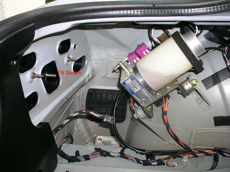

The usual problem with the tilt switch on the roadsters is that they drown due to water getting into the boot and finding its way to the lowest point, namely the left hand well behind and below the side trim. I would not expect water ingress to be a problem on the coupe.
Here is a pic of it on a my car:
When they drown, one of the characteristics seems to be an internal short that triggers the alarm even when it is not "set", so it can be going off whilst you are driving along!
