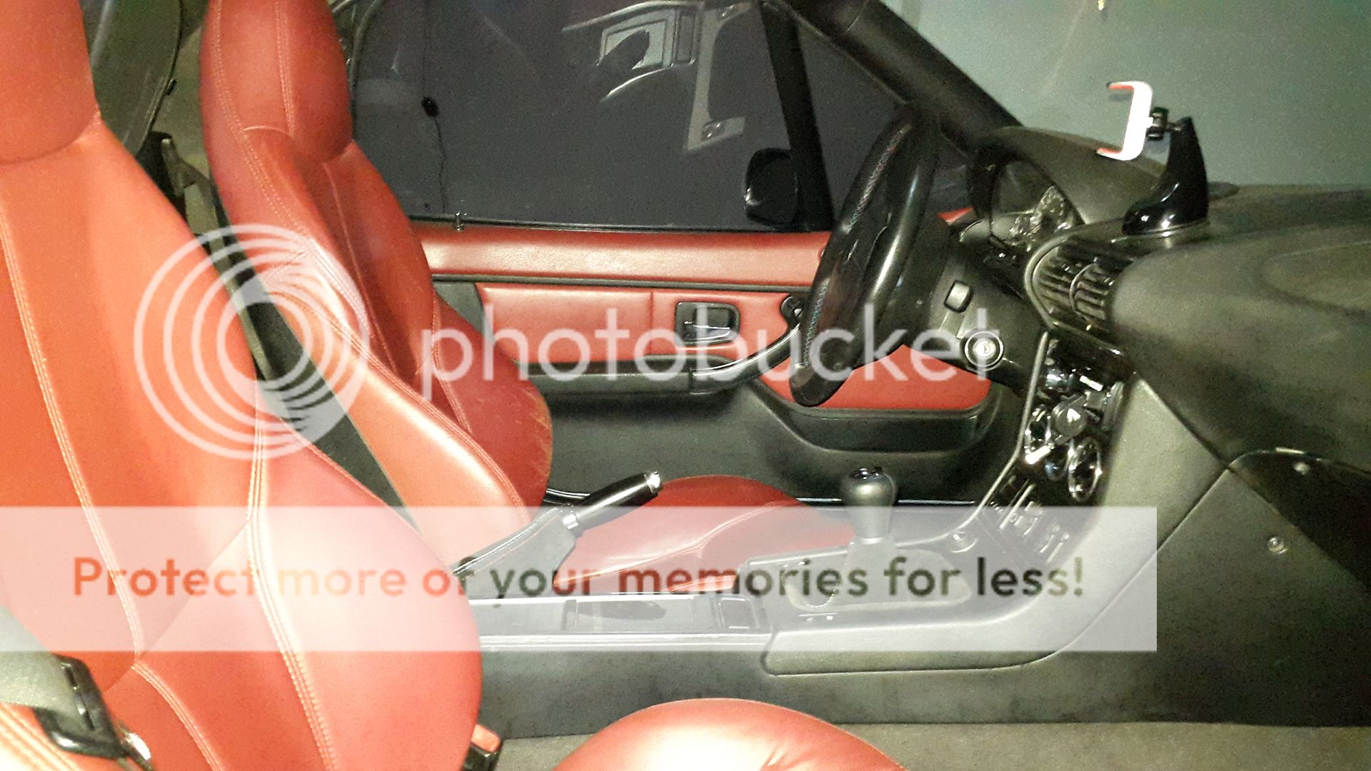

Post by Inferno » Thu 08 Oct, 2015 10:54
So this is how it looks, photo quality is very poor because on the lighting (ita actually looks a lot better than the pics), but you get the idea.
Not the best move i ever did, when you sit inside it's perfect but when you put the roof down the combo with the car color is weird. Anyway i knew this from the beginning but i had to take it mostly because it's really rare to find Z3M/Sportseats in Greece (ebay was not an option since almost none will ship outside his country). Next step to dye it black or purchase new Z3M black leather covers. Driver's seat has the fire extinguisher housing, now i will have to buy the OEM fire extinguisher.

Post by BladeRunner919 » Thu 08 Oct, 2015 11:37
I'd go for re-dying rather than getting covers. 99% of the covers I've seen fitted look terrible.

Post by Inferno » Thu 08 Oct, 2015 11:42
also the price difference is HUGE, 900€ for the new covers vs 110€ for the dying kit...
However i don't know how i will manage to dye the panels (because of the handle on the panel, it covers a part of the red leather) and i think i must again remove the seats and even worse, separate them from their metallic bases to do the best possible work, otherwise i will end up spraying the side plastics where the movement button is mounted..
