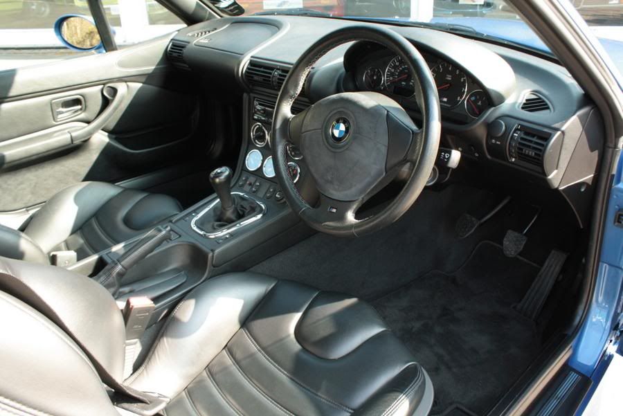

I am looking at buying the Z3 M Roadster in the picture below. It does not have the AC / recirculating button so do I take it that not all Ms had AC?

Re: Z3 M Roadster - Air Conditioning?
Postby swamper » Mon 18 Jun, 2012 23:14
i have noticed that that some dont seem to have it
Joined: Thu 13 May, 2010 17:14
Posts: 1719
Postby Jonttt » Tue 19 Jun, 2012 01:36
They all had it as standard in the UK but there are a couple of possible explanations:
- some early production press cars may not have had it
- the button may have been removed by another owner. Either becaue they removed the aircon or maybe because it was faulty (it can cost c£400 to repair).
Yuo are right to question this as it is a variation from the normal Z3m specification but there may be a simple explanation or a more devious one ;-)

Does it have an auxilliary electric fan in front of the radiator? If so then it had aircon and the button has been removed.

Postby HarveyT » Thu 21 Jun, 2012 19:10
An update on the elusive AC
The 'knowledge' from Munich Legends is that on the BMW 'data sheet' for the car, it states that it is a UK specification car without AC. So it appears that in 99 at least, AC was an option :?

Postby Z3cade » Fri 22 Jun, 2012 09:01
I have the spec sheet for mine and it doesnt include aircon. I also have no fan In front of the rad if that means anything ?
It must have been an option on early Ms.. Mines an Aug 98 S plate
///M Roadster
Posts: 2263
Postby Tilly » Fri 22 Jun, 2012 16:29
Z3cade wrote:I have the spec sheet for mine and it doesnt include aircon. I also have no fan In front of the rad if that means anything ?
I have the price list for Jan 1998.Aircon for the M roadster is listed as a £1100 option. The 1999 price list shows aircon as standard.
