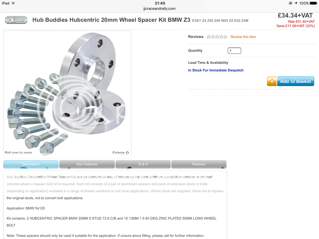

stevov wrote:JJC rally. 15 mm hubcentric supplied with longer bolts. Do not get the spacers that bolt on to your hubs and then you bolt the wheel to the spacer. A search will show why.
Great help there stevov, exactly what I'm after!
Can I just double check with those more mechanically literate than me, is it these ones (they seem cheap to me!);
Link:
http://www.jjcraceandrally.com/race/whe ... z8-e52-z4m

stevov
Joined: Sun 21 Dec, 2014 15:56
Posts: 174
Re: Hubcentric spacers for 2000 2.0 Z3
Post by stevov » Wed 02 Mar, 2016 22:21
That's the set I fitted to my car a year ago.. Well priced and good quality
